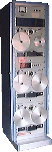

Here can be found some Information about the 35-Millimeter-Film-Recording-Machine (Base AMPEX 350 ?? used by Mercury??)
http://www.soundfountain.com/amb/mercury.html

Hello, I actually owned a 16mm magneto film recorder, made by Leevers Rich, what a monster!
The recorder had 3 decks, all of them driven from 2 capstan motors, there was a clutch operated system to engage the machines, the sprockets have a huge advantage that the tape was easier to synchronies.
