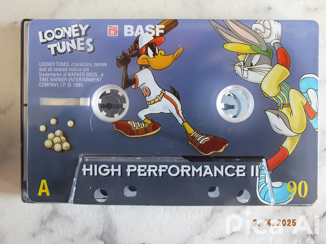

Hi, I have the Basf Hollywood cassette, but the serial number is a non-standard 11 digits.
So 1994 would be correct? I'm assuming it's a printing error and there's an extra "1" in the first place?
Regards EZ

Hi, the BASF Hollywood is from 1994, My example was made the exact same day as yours:
So yes, you have one “1” too much there - and mine is lacking a "0" at the end instead Wink
Regards

Hi, thank you, so I'm surprised, the Indonesian basf were probably quite irresponsible Big Grin
Hmm You also have a very good stock of rare tapes, so I can't surprise you so easily Big Grin
Regards EZ
