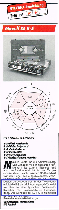

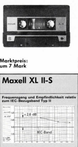

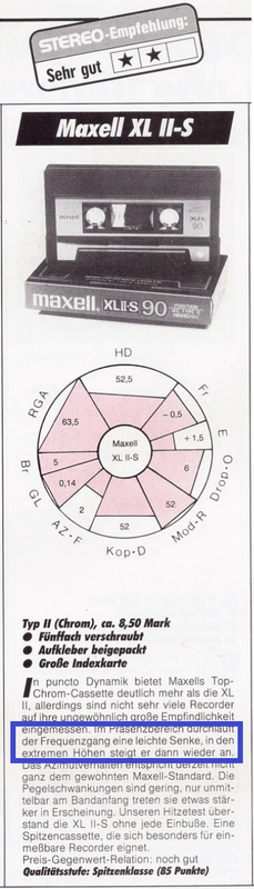

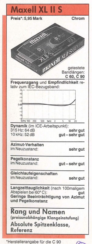

In den Tests der Stereo und Stereoplay liegt diese XLII-S in der Empfindlichkeit satte 1,7 und 2db über der SA.
Und auch der FQ Verlauf ist stark abweichend von der SA in die andere Richtung Höhenabfall von etwa 2db bei 10k.
STEREO 1985
Stereoplay 1985

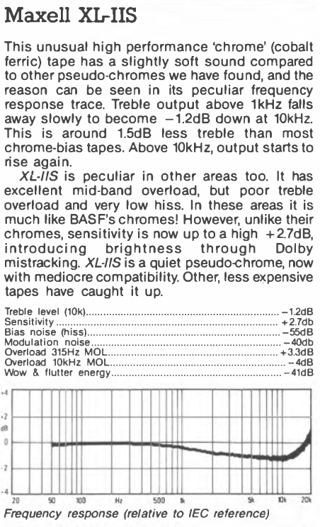

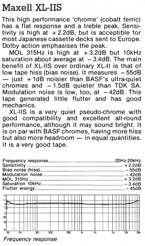

Auch WernerO's Messung bestätigt das: http://audiochrome.blogspot.com/2018/03/...nts_3.html
Ich muss mal in meine Aufzeichugen schauen, ob ich die auch schonmal gemessen habe, ansonsten hole ich das mal nach.

STEREO Aug 1987:
[Bild: XLII-S-STEREO-1987-08-bearb.png]
Stereoplay Mar 1989 (showing the typical dual-layer FR):
[Bild: XLII-S-Stereoplay-1989-03.png]
Edit (2): Yes, I don't know of any other occasion Maxell used dual-layer tape, either.

"Hi-Fi Choice" from the UK also mentions the dual-layer XLII-S tape. Strangely, I could only find them speaking of it as a thing of the past in their review dated Jan 1991 (see below, bottom).
I don't know what they mean by "a year back". Could be 1990, but also 1989, given that this issue dated Jan 1991 was probably published somewhere at the end of 1990. The closest previous review available is from the April 1989 issue and doesn't explicitly mention the double coating (see below, top). But the accompanying frequency response graph shows the typical curve of a double-coated tape IMO (it also closely resembles the FR graph of BASF's CR-SII, the ohly other dual-layer tape in this review). Just compare the two graphs from the 1989 and 1991 issues.
The strongly rising treble of the 1991 model IMO resembles 'Black Magnetite', which Maxell only started advertising a year or two later.
[Bild: XLII-S-in-Hi-Fi-Choice-UK-1989-04-o-1991...Markup.png]

This is a last (and final) tidbit I found (and rearranged to fit into one compact image): A review from STEREO magazine (German) from Aug 1989 where they reported a change from dual- to single-layer tape. I have no reason to doubt their measurements and their statements that are backed by those measurements. This is also consistent with what "Hi-Fi Choice" wrote, and puts a change from dual- back to single-layer tape (coating) somewhere around summer of 1989 (earlier than I assumed), and the "dual-layer era" (if it existed, which I believe) in the period from somewhere in 1986 to mid-1989. IMO the differences in before/after measurements cannot be explained by a change in base film.
What's weird is that these measurements do *not* show the rising treble that the (slightly later) "Hi-Fi Choice" measurements show.
[Bild: XLII-S-in-Test-STEREO-1989-08-m-Markup.png]

The 1985 "Hifi Choice" tape review (no month for the issue given) indeed also shows the mid-range dip:
[Bild: XLII-S-in-Hi-Fi-Choice-UK-1985-cr.png]
The STEREO (Germany) review from August 1985 also mentions the upper mid-range (presence) dip:
[Bild: XLII-S-in-STEREO-1985-08-m-Markup.png]
However, a "Stereoplay" review from April 1985 does *not* show it (while it does show an extremely high sensitivity, and overall their deck seems to have been adjusted differently, as other known dual-layer tapes like Agfa & BASF, except for TDK's SA-X, show no presence dip in their measurements, but steeply rising treble instead):
[Bild: XLII-S-in-Stereoplay-1985-04-cr.png]
