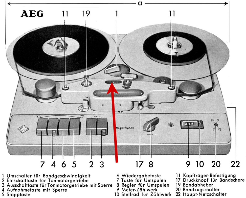

‘Evert’,’index.php?page=Thread&postID=229544#post229544’ schrieb:Can you tell me where I can find the azimuth screws on both heads?
The azimuth screws are underneath the small cover plate on top of the head block, marked by the red arrow in the following picture:
[Bild: M5-Laufwerk.jpg]
